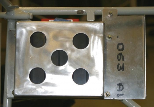

Brief Description:  Battery Mount 4

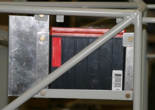

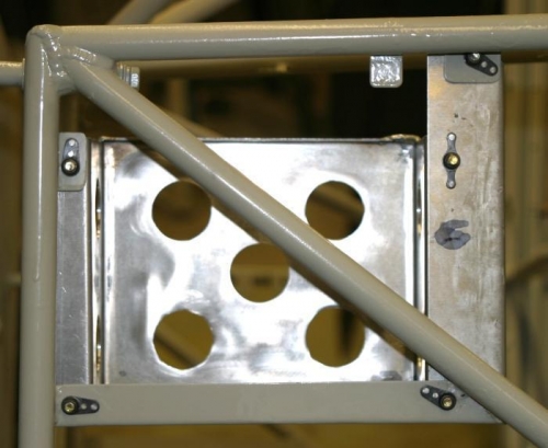

I cut out, bent, lightened and TIG welded another battery box for the left side, including nut plates. I mounted the right side, but ran out of -4 nutplates, so it's provisionally mounted with nuts and bolts. A larger side bracket was made for the right side, as the majority of the wiring will be on this side and I will mount the starter and master contactor and current limiter on this side. Of course, it will have to be alodined, primed and coated, as well.
Left side, view from outboard

Right side, outboard view
Right side, inboard view
