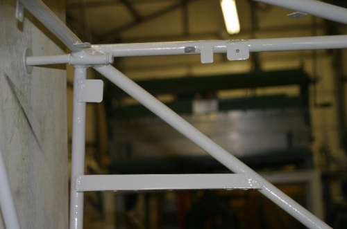

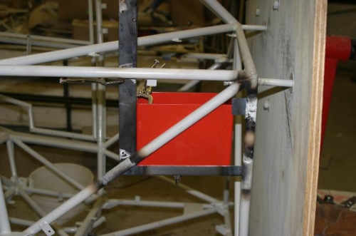

I fabricated battery mounts, which will mount Odyssey 680 batteries just aft of the firewall. I haven't decided whether to go with two batteries or one, or which side to mount one battery, so I put mounts on both sides. I used .050 right angle channel as the base, and two tabs at the top to mount an aluminum Odyssey bracket.
Jigging the tabs.
Jigging the tabs.
Outside view, right mount.
Inside view, right mount.
