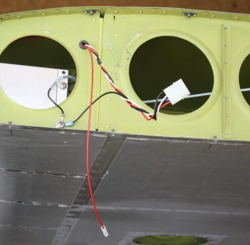

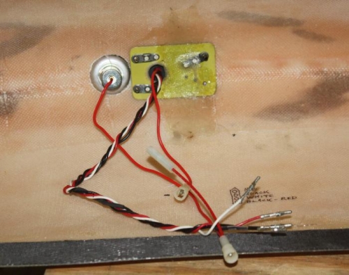

I installed the strobe power supplies inside the outer ribs, forward of the front spar, using 3 each 10-32 self-retaining Monadnock fasteners. I made an extension cable for the high voltage wires from the supply to the strobe, so that I can disconnect the Nav/Strobe wires using Molex connectors while they are in plain sight when it comes time to remove the wingtips.
Wingtip Nav/Strobe fixture wiring view showing glassed in retaining backing plate.
Mounted strobe power supply and associated wiring.
