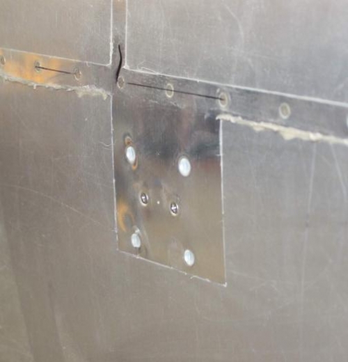

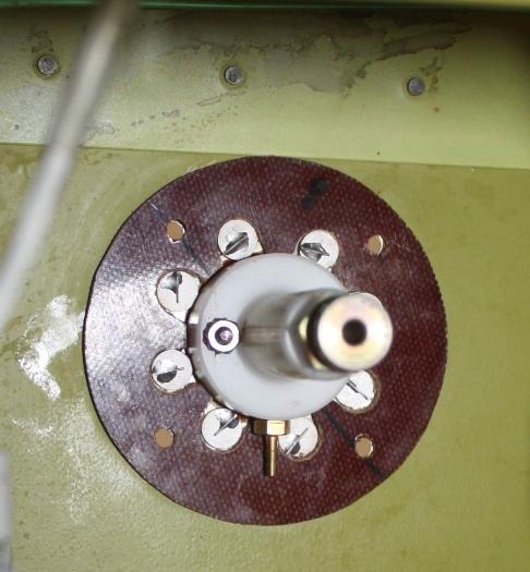

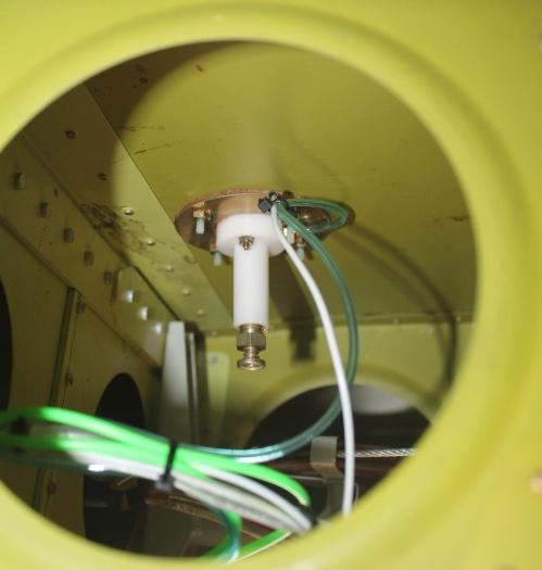

I installed the upper surface AOA bits; they included thermistors for the AOA heat and drilling a hole in the lower access panel so the AFS drain probe could drain the upper fitting without removing the panel.
Thermistors installed.
Bottom view with fitting and drain shown.
Upper surface.
