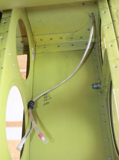

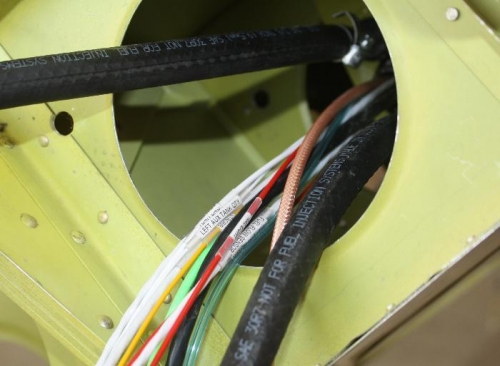

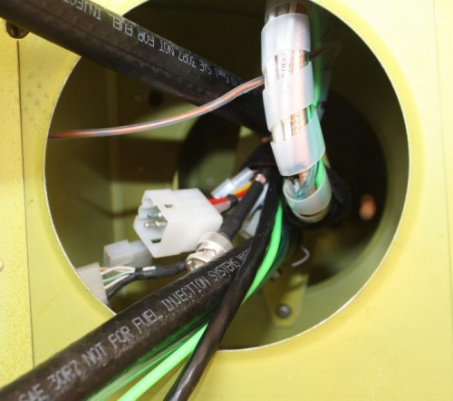

At the root, I labeled the wires and installed the Molex connectors, leaving enough length for a service loop and staggering their position. For the main fuel tank sender wire, a penetration to the inboard tank was needed. Fortunately, there is a jig-keying hole in the spar which allows the wire to pass with nylon tubing around it for strain relief.
Wire labeling.
Wire labeling.
Connectors installed.
Main fuel tank sender wire penetration.
