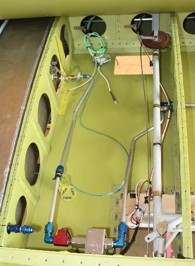

I placed standoffs using pop rivets to support the wires as they leave the conduit, labeled the wires and connected them to their respective components, incorporating a service loop to aid in any future maintenance.
Aux fuel qty sender, pump, flow sensor, AOA heat  wiring.

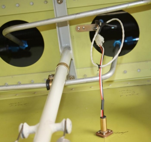

Temperature probe wiring.

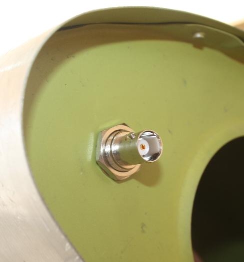

Marker beacon bnc connector at wingtip.
