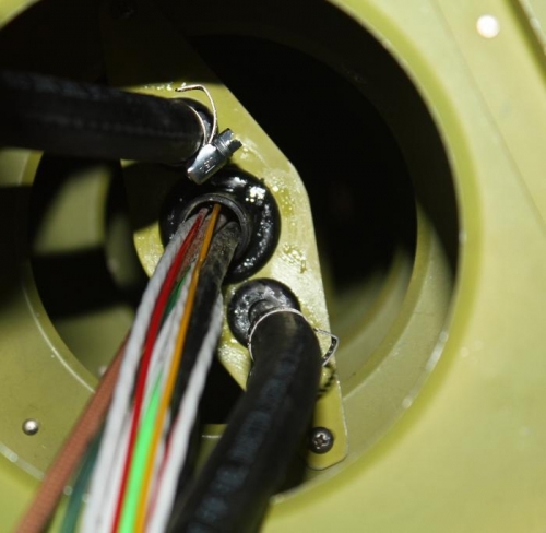

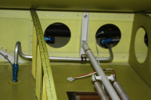

I installed the fuel vent lines in the front of the left wing, and fabricated the outboard main-aux vent line connection and the other wing carry-over to the fuel vent. The inboard wing hose connections wear beaded, and 3/8 inch ID Gates fuel hose was installed. I also decided to place Koroseal figure-of-eight bindings to connect the fuel vent lines and wiring conduit in between the conduit brackets in order to minimize repetitive deflection of the wiring conduit and protect the vent lines from contact from the corrugated conduit during vertical acceleration. I'll need to do that on the other wing, too.
Right wing to left underwing fuel vent fitting.
Inboard fuel vent hose connections.
