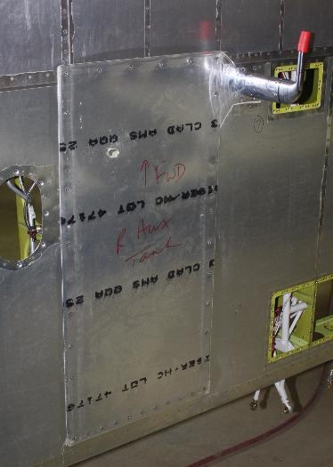

I installed the nutplates for the aux tank; on this side I dimpled the spar screw holes rather than countersunk them, and it worked fine, which should be a stronger construct.
Dimpled.
Trial fit.
