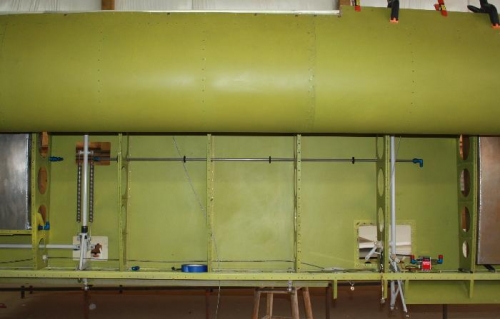

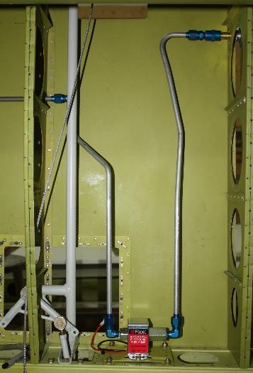

I fabricated the fuel lines from the aux tank to the main tank. I decided to make the run from the aux fuel pump to the main tank in two sections. The inboard piece is one straight line to the aux fuel pump bay using AN931-6-16 grommets, which allows the line to be passed through the front flap linkage access panel. Once the line was passed, the grommets had to be pushed into the holes. The aux fuel pump to the 90 deg elbow of the straight fuel line uses two 45 deg bends for horizontal offset and a 15 deg bend for vertical offset. The aux tank to aux fuel pump uses a 105 deg and a 15 deg bend to achieve the offset.
