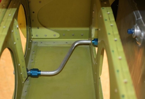

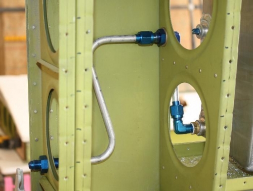

I used 5052 aluminum 3/8 inch OD x .035 inch wall tubing to make the fuel tank to inboard rib fuel lines. The front fuel line uses 45 deg bends to get the offset and the aft fuel line uses 105 deg bends to achieve the same result.
Front main fuel line.
Aft main fuel line.
