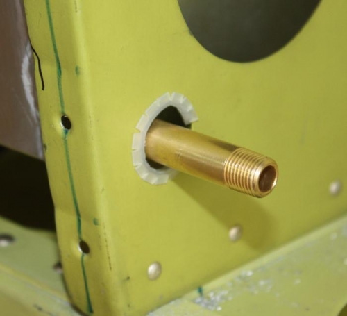

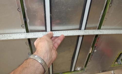

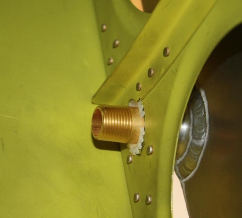

I took the straps I'd previously made and drilled out spar rivets and reamed out to 3/16 inch for the straps to be bolted to. The front spar rivets have to be drilled out from the shop head, which can be a little tricky to remain centered. Using two bottom straps and one top strap, I achieved what appeared to be a fit, and primed and painted the straps and glued the one inch rubber straps onto the 3/4 inch straps. The tank fits very closely to the ribs, and the only way I could think to attach fuel lines without huge holes was to use brass nipples to get the fuel into the next bay, where a coupling and AN-pipe adapter can be used to hook up the fuel lines. I used a rivet strap duplicator to scuff the paint in order to figure out where to put the holes in the rib. The aux tank went in and out about a dozen times. Each time the tank tends to end up in a slightly different position. Because of that, next time, I'm not cutting out the fuel filler neck until everything is already done.
Aux fuel outlet.
Aux fuel outlet.
Aux fuel vent.
Aux fuel vent.
Barely enough room.
Barely enough room.
