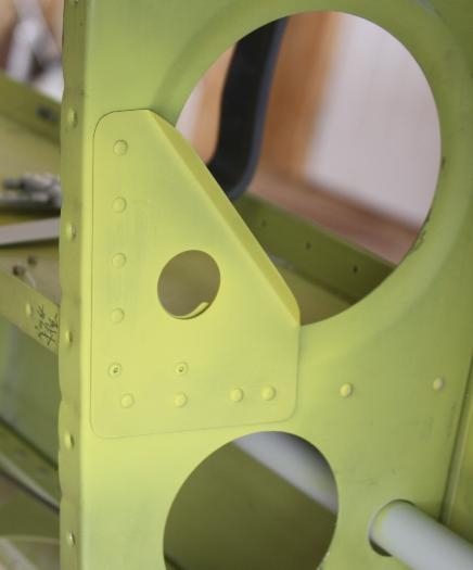

Brief Description:  Fuel Vent Doubler
Trial fitting of the fuel tank indicated that the lightening hole flanged portion would be violated. Accordingly, I made a .025 doubler with a bend with the hole in the appropriate place. I ended up using two 3/32 inch cherry pop rivets, because my calculations were ooff about 1/10 of an inch to close to the spar to allow solid rivets. Lesson learned.
Main tank fuel vent doubler.
