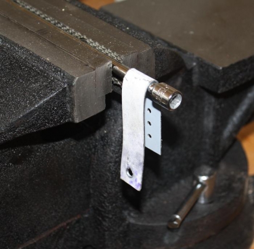

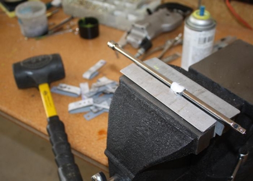

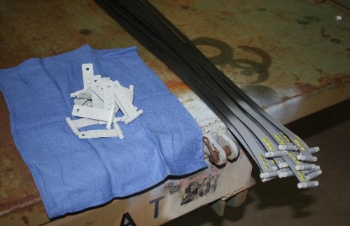

I made the various fuel tank straps; 6 upper and 10 lower using the Avipro supplied materials. I set the short strap length so that the tensioners would be midway along the aft and front spars when at their maximum length. I used 3 AN470-4 rivets as shown in the Beartracks drawing, which details the fuel tank mounting. To get the bends right, I used a 1/4 inch socket extension to bend the strap around, and then placed the ends into the vise using aluminum angle so as to avoid scratching the metal set at at a gap narrower than the socket extension and pounded on the strap with a rubber mallet as I slowly tightened the vise. I primed the straps using self-etching primer and dipped the rivets in zinc chromate prior to setting them. The short straps were then painted with Ford light tractor grey, as they are pretty much done.
Strap bent over 1/4 inch socket extension.
Pounding strap down.
Straps prior to fitting them.
