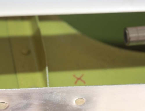

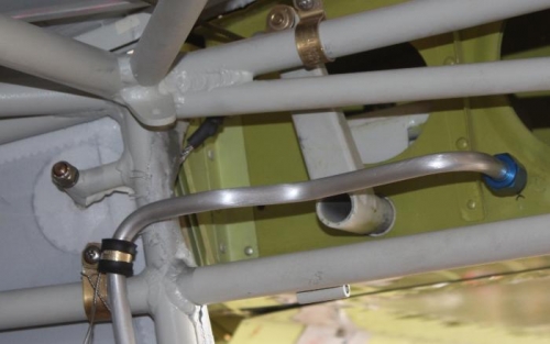

I wasn't thrilled with the concept of using hose clamps and rubber fuel hose in the wing roots, and spent some time pondering how to use standard AN tubing. I used the tools in Image 1 to help figure out the geometry. I cut off the straight and 90 deg flare fitting from a bulkhead and bent a 90 deg tube with a standard 3/8 inch tubing bender with the sleeve and nut mounted at the minimum length possible to get the nut to fit on a tubing bender. The mylar template and the transfer punch were used to help locate the proper position of the bulkhead fittings on the root rib. I ended up using a straight bulkhead union on the aft lines and a 90 deg bulkhead union on the front tubing. I was able to flare the aft tubes, but only cut the forward tubes as there wasn't enough room to get the flaring tool in there with the wings on.
Tools used to fit tubing.
Front tubing location.
Aft tubing location.
