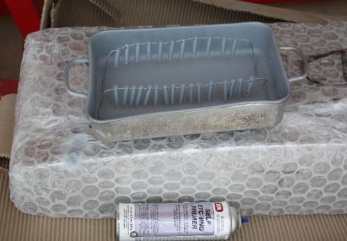

The tank strap tensioners had some mild corrosion on them, and they didn't easily thread the 10-32 screws. Accordingly, I chased the threads with a tap, then tumbled them to remove the corrosion and primed and painted them with Ford Tractor Light Grey.
Primed.
Primed.
