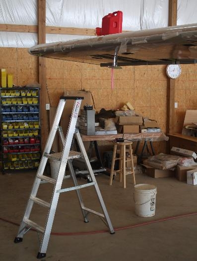

Brief Description:  Fuel System Flush and Leak Test
I flushed out the fuel system using Mogas with the aircraft level. I started with 2 gallons of fuel in the aux tanks, draining the gas out the fuel drain bung. I installed the quick drains, and put another couple gallons in the aux tank, and activated the aux tank transfer pumps, transferring fuel from the aux tank to the main tank with the fuel drain bung open. I then poured a couple gallons of fuel into the main tanks, and after that had drained out the open fuel drain bung, I installed the quick drain. After putting another couple gallons into the main tanks, I then removed the quick drain from the gascolator, and placed the fuel selector valve into the Both position and drained the two gallons of fuel from both tanks through the gascolator.
Fuel flushing.
Fuel flushing.
