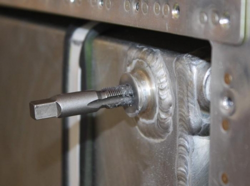

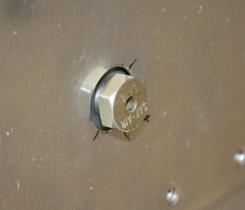

I used a Brown Tools transfer hole punch to determine the location of the hole on the fuel access panels. I ground off a few mm of drain fuel bung to gain additional clearance from the panel, and then needed to freshen up the pipe threads. Adequate fit was achieved.

Freshening threads.
Freshening threads.
Saf-Air drain.
Saf-Air drain.
