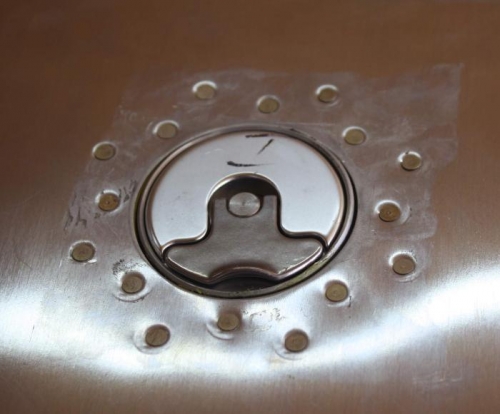

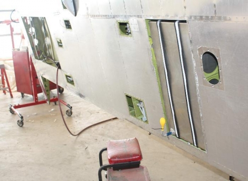

Prior to riveting the outboard upper trailing edge, I needed to install the fuel tanks so that I could reattach the aux fuel vent, which is in a location unaccessable after the pocket rivets in place. I then pressure tested the currently installed lines. I needed to use a very low pressure as the aux tank made ominous noises when pressurized. I adjusted the fuel tanks as much as possible to position the fuel fillers appropriately. Loctite was used on the fuel tank strap screws to prevent loosening.
Pressure Test.
Pressure Test.
Main tank filler.
Main tank filler.
