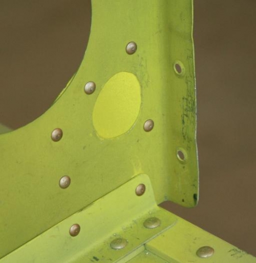

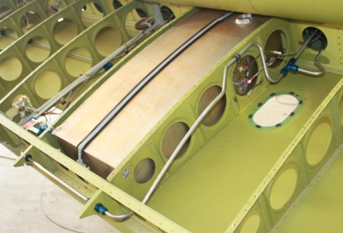

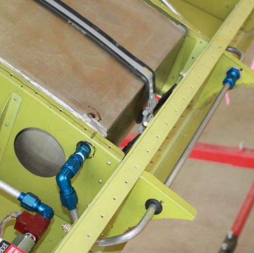

On the right aux tank, I patched the previous rib hole for an outboard fuel vent, and then welded an inboard flange aft on the fuel tank, marked the penetration point on the inboard rib, and fabricated a new vent routing similar to that finalized on the left wing. A nutplate was secured to the rib in order to stabilize the outboard line with an Adel clamp.
Patched outboard rib.
Inboard vent line.
Inboard vent line.
Aft and outboard vent line run.
