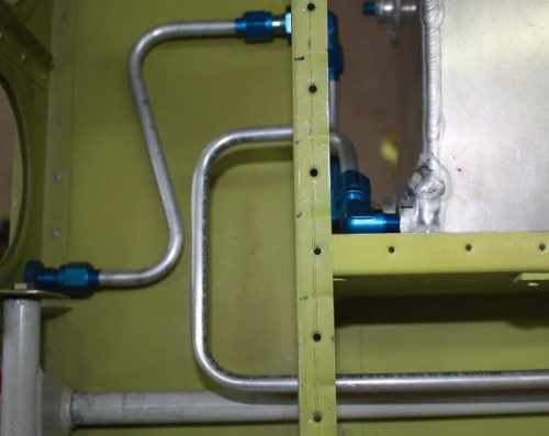

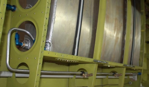

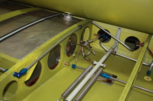

I TIG-welded a new aft vent line flange on the right main tank and fabricated a new line to run outboard, up and forward to connect with the existing front nose rib vent line. I pop-riveted a nutplate to secure the forward running line to the rib.
Inboard main tank vent tubing and welded flange.
Aft main tank vent line run.
Inboard main tank vent line.
