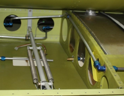

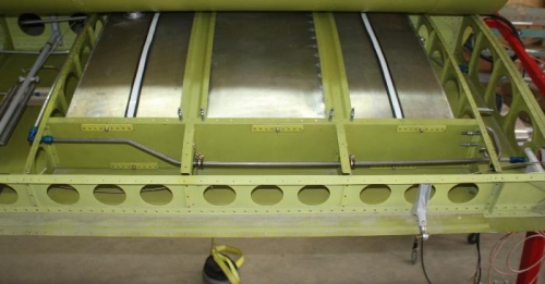

I made a doubler for the inboard main fuel tank rib and made a cutout for the fuel line. I used two supports and a 90 deg bulkhead elbow to allow the line to connect to another piece of tubing, which connects to the forward vent line.
Main inboard doubler, aft vent line "U".
Aft main vent line with supports.
New outboard main vent line.
