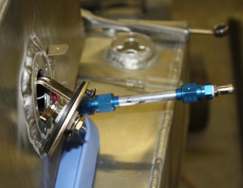

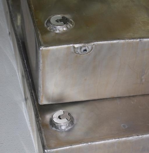

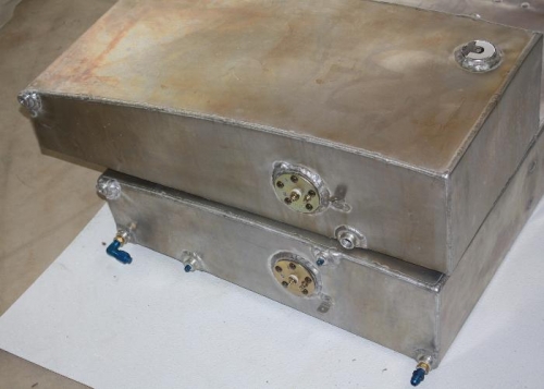

I welded the fuel tank sender flanges, ground tabs, and fuel filler necks. Midway through the process, I got to thinking that I may have screwed up the fuel vent plumbing. So I pulled the diagram that I'd written three years ago, and although I had checked it before starting the vent plumbing, I had in fact ran the plumbing wrong. Basically, I wanted the vents to come off the tanks inboard, not outboard. So, I welded new inboard flanges on these, the left tanks prior to rerouting the vent plumbing. After the welding, I flushed the tanks with water and detergent to get rid of some of the shavings, and then lightly alodined the the tanks after scuffing with alkaline detergent. I determined the fuel tank sender float lengths, which turned out to 3.5 inches for the main and 4.0 inches for the aux tank. I inserted the senders, clocked them to achieve full travel and installed them, and pressure tested the tanks. No leaks.
Assembling fuel tank sender for pressure testing.
Fuel Tank senders, grounds and inboard vent welded.
Fuel fillers.
Fuel fillers.
