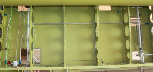

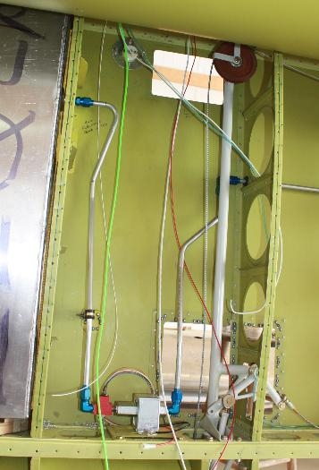

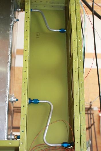

Brief Description:  Fuel Tank Plumbing 3
I made 5052 fuel lines, pretty much the same as the other wing, and attached them so the fuel tanks would be even more constrained. This included mounting the aux fuel tank to aux fuel pump support, which required dimpling and installing 6-32 nutplates in the mount.
Inboard fuel lines.
Inboard fuel lines.
Aux fuel pump to main tank fuel lines.
Aux fuel pump lines detail.
