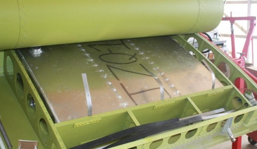

Brief Description:  Fuel Tank Straps 3
I temporarily mounted placed rubber channel on the previously fabricated straps and placed the fuel tanks in their bays, and adjusted the lengths of the straps such that the tanks would be suspended in their appropriate positions. Once I had achieved the correct lengths, I cleaned, scuffed, primed and enamel painted the straps. After the paint sets, I'll use 3M adhesive to get the rubber channel to adhere to the metal straps.

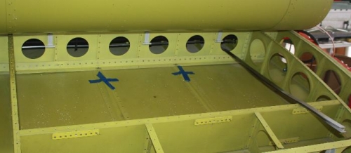

Washers taped to access panel ribs.

Bottom straps being trimmed to fit.
