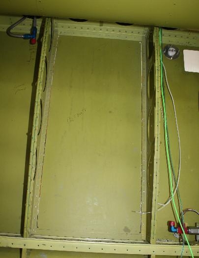

I cut out the third bay from the tip on the left wing using a Dremel-like tool, and finished it with files. I then cut a panel out of .032 inch 2024-T3 using 0.5 inch center-edge distance. I'll save the dimpling and nutplates for later.
Cutout in process.
Cutout in process.

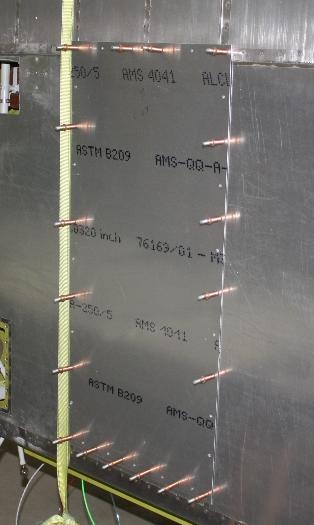

Trimmed access panel in place.
