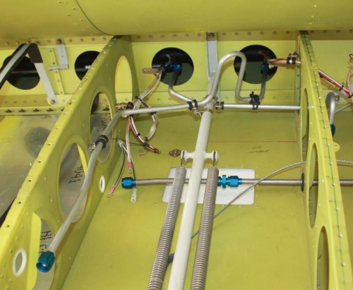

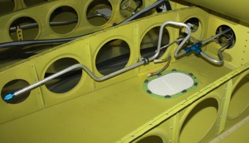

I had forgotten to put a loop in the fuel vent lines near the front of the fuel tanks on the right wing so that the fuel won't drain out the vents in a tail down position. Accordingly, I made new aux and main fuel vent lines incorporating that feature.
New main fuel vent line.
New aux fuel vent line.
