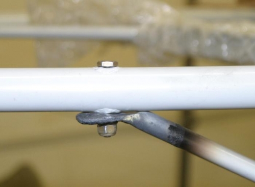

Brief Description:  Tailstrut
My right tailstrut was too long, even after the elevator and horizontal stabilizer were adjusted to within 0.1 deg of horizontal. Avipro sent me a couple of tailstruts, but they were all too short. I ended up getting my original tailstrut back, redrilling the hole and filling in the original hole by welding, which solved the problem.
After adjusting fit
After adjusting fit
