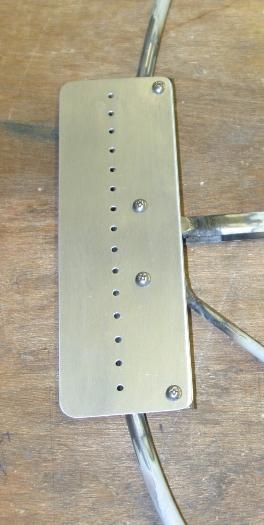

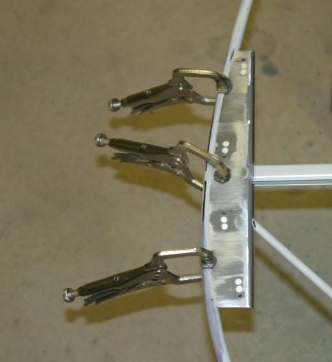

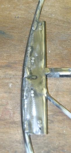

The Avipro kit doesn't provide for a ground adjustable rudder trim tab; the second prototype has the tab screwed into the tubing and channels. That is a lightweight solution, but I'd prefer not to be screwing into the aircraft structure. So a small metal bracket with nutplates was skip welded to the aft rudder which will support the trim tab.
Before welding
Before welding
After welding
After welding
