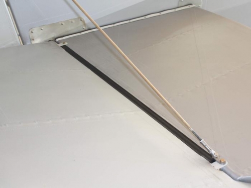

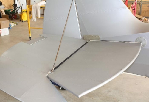

Brief Description:  Horizontal Stabilizer and Elevator Gap Seal
I'd purchased a set of gap seals from www.aerographic.com for both the rudder and elevator. I've been noticing power is required to bring the nose up at slow approach speeds. Also, I couldn't bring the nose up enough to stall the aircraft with 3 notches of flaps at altitude. These took only a few minutes to put on, fit nicely and hopefully will enhance elevator effectiveness in addition to decreasing drag. So far, I've not noticed any lack of rudder authority so I'll hold off on putting that one.
Aft view.
Aft view.
Front view.
