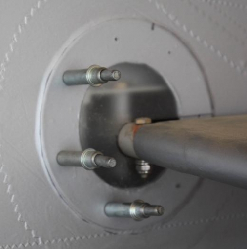

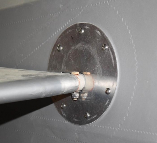

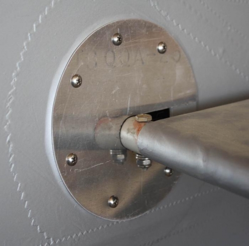

I fabricated the front stabilizer fairings out of .025 inch 2024-T3, and used clear plastic templating material, which makes it a little easier to locate where the hole for the stabilzer tube went. The fairing is secured with #6 x 3/8 inch sheet metal screws.
Using clear plastic templating material.
Left front stabilizer fairing.
Right front stabilizer fairing.
