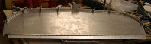

Date:  10-15-2006
Number of Hours:  3.50
Brief Description:  Instrument Panel Bows and Compass Support
I shrunk a set of right and left .032 in 2024-T3 bows to fit the contour of the panel; they are joined in the middle with an additional support for the Precision Aircraft vertical card compass. I made the bows in two sections, as it's easier to get half contoured appropriately than both sides simultaneously, and I wanted to fabricate a support in the middle anyway. I won't alodine, prime or rivet until I've cut the instrument and radio holes.
