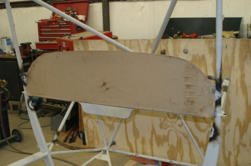

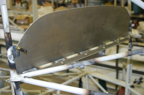

I welded tabs with nutplate holes added to support the panel; I'll use floating nutplates so I can vary the panel tilt as needed. I also installed a control subpanel, so I'll have more room for avionics.
Upper Panel Support Pads Welded.
Subpanel For Controls Added.
