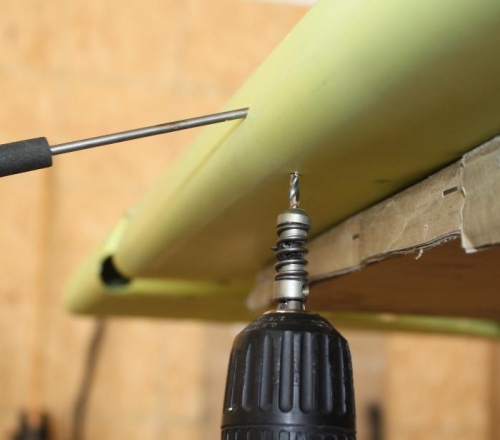

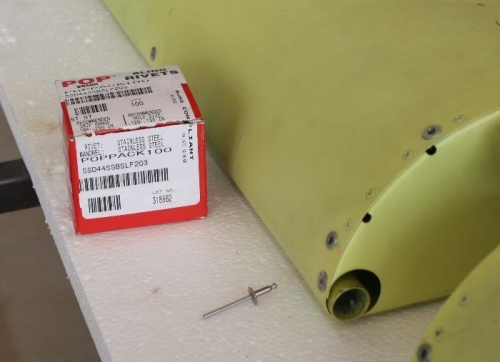

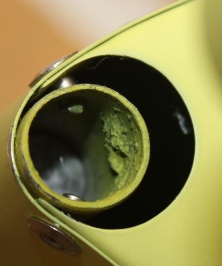

I installed the balance tubes into the ailerons using wide dome, long grip stainless steel 1/8 inch rivets from McMasters. I used a right angle prick to help pull the tubes into the leading edge.
Pulling balace tube into leading edge.
Tube capture.
Finished product.
