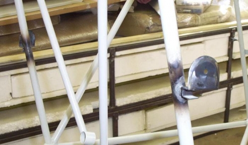

Brief Description:  Static Port Mounts
I bent some .030 4130, and formed it to taper away from the fabric and welded it to standoffs aft of the baggage door; I plan to use an AN470-6-14 3/16 in rivet and drill a hole in same and secure it to this mount with a 3/16 in push on fastener. After I get a few other fuselage weld mods, I'll prime and paint it.
Static Port Mounts Welded To Standoff
