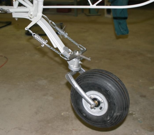

Brief Description:  Tailwheel 2
I swapped out the original Barrows tailwheel for a Tundra Tailwheel; I plan on basing the aircraft in a pasture, and the small tailwheel would likely bog down when the ground is soft. Safety wire is used to compress one of the steering springs to aid in hooking it up.
