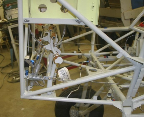

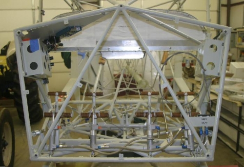

Brief Description:  Brake Hose 2
I used Russel Powerflex flexible brake hoses for the high pressure side of the flexible brake system; I'll use Nylonflow for the low pressure side, but I'll wait until the engine is mounted so I can avoid potential conflicts with mounting the brake reservoir.
Russel Powerflex brake hoses & Matco Parking Brake Valve
Aluminum hard lines from Parking Brake Valve to Bulkhead
