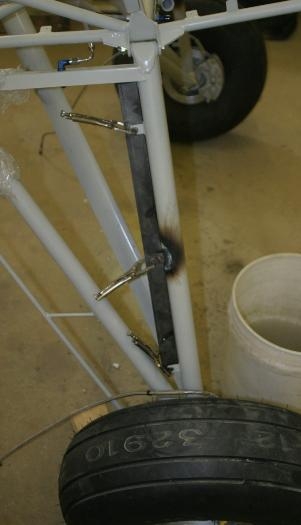

Brief Description:  Brake Hose Support Tabs
I had to maintain a lot of tension on the flexible brake hose I am going to run in the landing gear to keep it centered and away from the fabric; that didn't sound like a long term solution as Adel clamps alone wouldn't hold the tension, I ended up having to use Tie-Wraps, as well. I decided to add an addition tab midway between the existing ones so that shouldn't be an issue.
Additional midway brake hose tab
