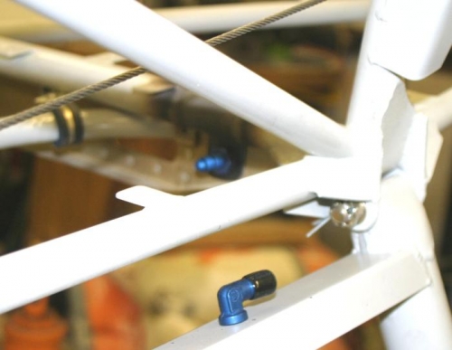

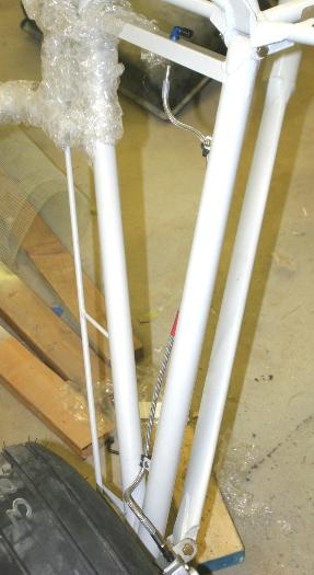

I installed a 32 inch Powerflex brake line from the brake caliper to the top of the landing gear. I wrestled with ways to go from the 90 deg bulkhead fitting to the hard lines up to the parking brake controller, and ultimately decided I needed to have a "hard" bulkhead to make the transition, as I didn't want flexing from the gear to work on the hard lines. So, I broke out the gas welder and welded a pair of tabs onto which the bulkhead fitting would mount.
Powerflex brake hose
Mounting tab for bulkhead flare union
Bulkhead union installed
