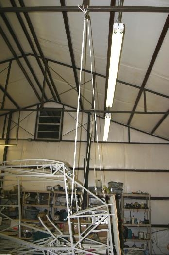

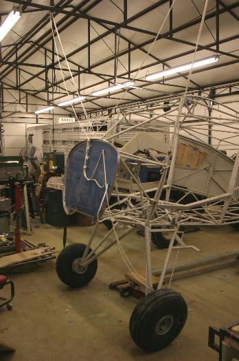

Brief Description:  Installed landing gear, struts and brake calipers
I raised the fuselage off the rotisserie using 5/16 nylon cord and a pair of two pulleys set into the overhead framing. I set it provisionally on a sawhorse with a couple 4 x 4's stacked on it, and had to deflate the tires to get the 8.5 x 6 tires mounted. There appears to be plenty of clearance between the landing gear and the calipers using the stock spacers. I wanted to install the tailwheel, but I need to purchase a 7/16 inch reamer first.
Pulleys used to raise fuselage
On the wheels
On the wheels
Calipers in Place
Calipers in Place
