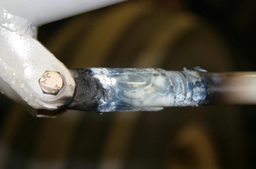

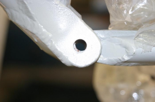

Brief Description:  Streamline Shock Strut
I bought a pair of the new "streamline" shock struts, but the first one I tried to install didn't fit well. Mark Goldberg asked Mr. Barrows, and they suggested adjusting the strut about 1 inch above the fitting, which worked well. The left, pilot side, shock strut fit well without adjustment. Next, I'll have to drill the plugs and tap them.
About 3/32 in malalignment.
It fits now!
It fits now!
