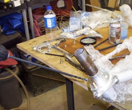

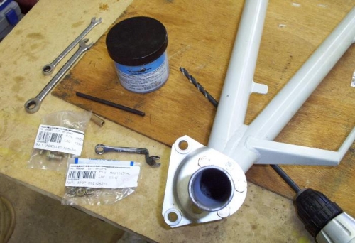

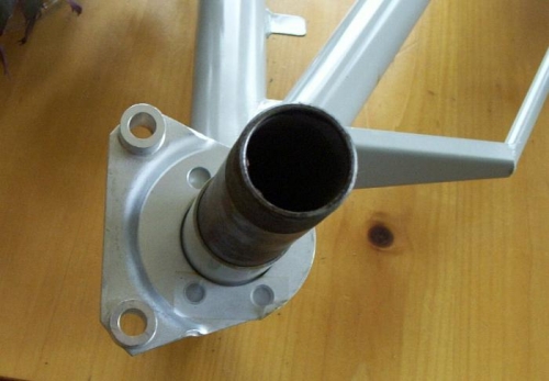

Today I mounted the Cleveland 199-62 Two Puck Brake Caliper Mounts. Only three of the stock mount holes can be used; there is too much interference from the welded tubes to mount the upper right bolt. On the stock mount, two small bushings are used to convert the 3/8 in holes so as to fit a 5/16 in bolt. The one upper stock hole which is useable utilizes a -5 bolt and that bushing. In order to get 4 mounting bolts, I drilled another additional 5/16 in hole more toward the three o'clock position. To aid in centering the mount, I put a few wraps of metallic itape on the stock spacer so as to take up any play, and clamped the mount to the gear leg with a vise grip. I found a 3/8 " OD 1/4 in ID bushing to be ideal in order to center the transfer punch. Also, using 12 in long "aircraft" drills seems to be necessary to clear the axle. I bent a 3/8 in wrench to aid in tightening the -5 nuts (see image 2). Finally, MS21042-5 nuts are lower profile than AN363 nuts, which really help in getting a nut on the top -5 bolts. I also drilled the cotter pin holes in the axles and set everything aside, waiting for tires and tubes. I had to weld up a small nick in the steel tube on account of a drill pulling through the hole I was drilling, scratching the tube, also necessitating priming and painting. The 8.50 x 6 tubes are on backorder, because the factory making them is out of business, according to Desser.
These three holes can be drilled
Tools and hardware needed
Using Bushing To Center Drill Bit
