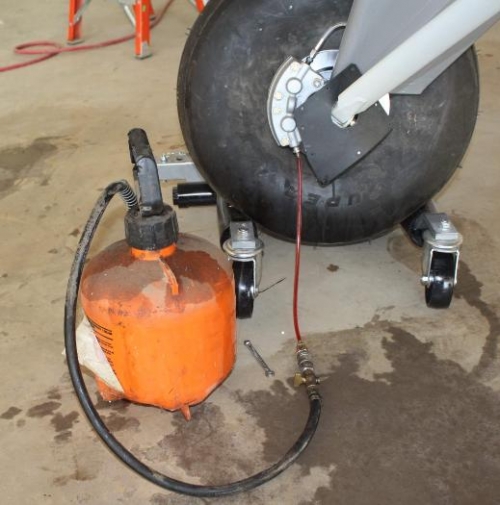

I back bled the brakes, and found a few leaks in the process, which responded to tightening the AN nuts. I double-checked the brake pedal geometry to make sure that the pedals wouldn't go into an overcenter condition, that would lock the brakes on. There was no such problem. I also topped off the landing gear shock with ATF, as well.
Back bleeding ready to go.
