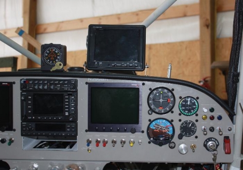

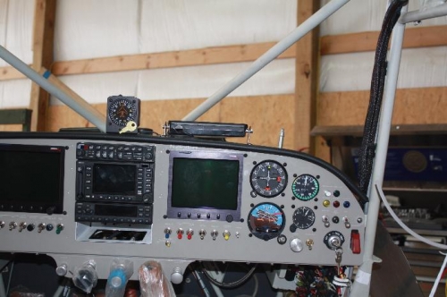

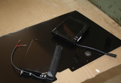

I decided to use an inexpensive 6 inch headrest lcd monitor, and I fabricated a mount using wave washers and locknuts to provide friction in order to keep the monitor in the flipped up or down position, as selected. I placed a microswitch on the left side of the mount so that when the monitor is flipped up, power is provided to the monitor and the camera. Final wiring will have to wait until the wings are mounted on the fuselage as the proprietory cable cannot be split, but I ran a power line from the fuse box.
Monitor, mount, and panel cover.
Monitor flipped down.
Monitor flipped up.
Monitor flipped up.
