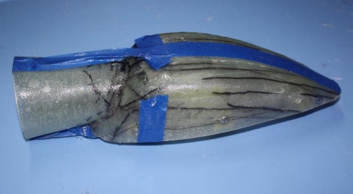

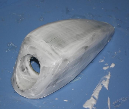

I made a fiberglass cone by wrapping 3-ply around a styrofoam flower cone bought at Hobby Lobby which was covered with electrician's tape and carnuba wax as a release agent. After the epoxy set, I removed the foam. I mounted the infrared camera within the fairing using 6 each screw holes. I applied a 1/16 inch gasket to the ring around the camera lens and fit the cone into the front end of the fairing after grinding out a hole in both the fairing and the end of the cone. I fiberglassed the cone in place outside first, then the inside,and then cut the redundant external cone off, and sanded the fairing. I applied a coat of microballons and epoxy slurry, and smoothed the fairing by sanding, followed by sandable primer, followed by rattle can Ford Light Grey enamal.
Cone fiberglassed in place.
Epoxy microballoon slurry applied.
