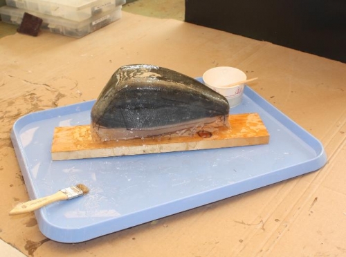

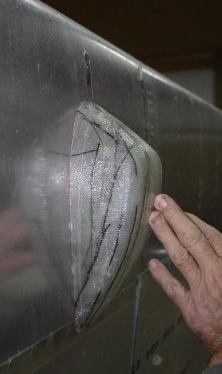

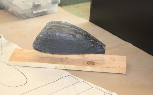

I decided to go ahead and order it, as it provides a significant safety improvement for night ops at an unimproved airport, such as mine. Accordingly, I used the specification drawing to design a fairing, made a male plug out of blue foam, covered same with electricians tape and applied wax release agent, and covered it with 3 layers of fiberglass cloth and epoxy. After drying, I removed the plug and trimmed it to fit.
Male plug with wax as release agent.
3 ply of multidirectional ply epoxied in place.
Trimmed to fit.
Trimmed to fit.
