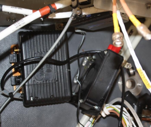

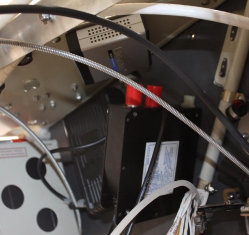

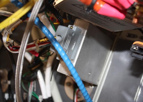

Brief Description:  Four Little Boxes
All of the major electronic components have been mounted, except for four little boxes - Wx Works receiver, avionics fain, Linksys SD205 router, and the Advanced Flight Systems ARINC module. I wanted to wait until the control cables and major wires were ran until placing these items, in case of potential conflicts. I fabricated a bracket to elevate the Wx Works mounting tray. I mounted the Avionics Fan using three nutplates added to the frame. I couldn't find a suitable mounting place for the ARINC module utilizing the existing mounting points, so I disassembled it and added two nutplates to the end. I also fabricated a bracket to keep the power plug cord in the router. I ran the necessary wiring; and shortened the Wx Works RJ45 cable so as to allow it to fit into the router with not as much redundant length.
Wx Works and Avioinics Fan.
Avionics Fan and Ethernet Router.
ARINC module.
ARINC module.
