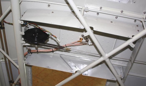

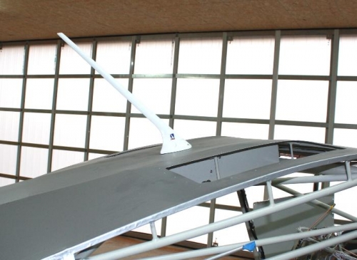

I installed a Comant CI 2480-400 antenna, which will provide COM, GPS and XM signals to the GNS-480. I fabricated RG-400 cable with the appropriate BNC, TNC and SMA right angle connectors, respectively, and ran them down the right front door post.
Top View
Bottom View
