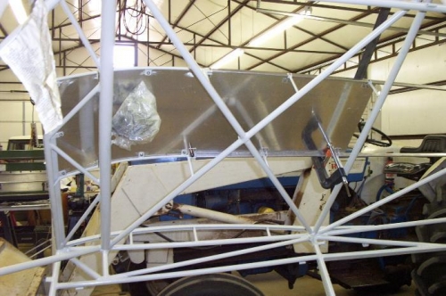

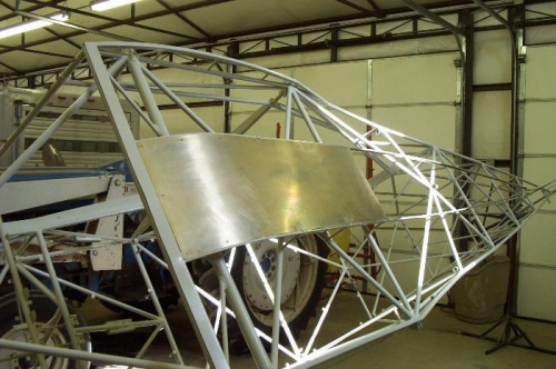

Brief Description:  Overhead Antenna Mount Fabrication
I fabricated this overhead antenna mount from .032 2024-T3; 6-32 countersunk screws in front into the welded on tabs, right angle brackets into the standoffs and -4 countersunk rivets aft. The reason it took so long, is that I tried originally to make it all one piece with bends instead of brackets, but the stringer standoffs aren't exactly linearly placed, and I couldn't get the bends right. It's fairly sturdy, but it will probably need a doubler for the Comant antenna, which will combine VHF, GPS and XM output. It's on backorder from ACS, so I'll wait till it arrives before I do any more on this part. I alodined this and several other parts, as well.
