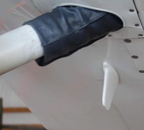

Brief Description:  Transponder Antenna
Coming back from the paint shop, my transponder stopped working. Checking the connections, it appeared the swizzle stick antenna was slightly loose in it's housing, allowing it to rotate. Kelley Babin is no fan of the swizzle stick antennas when used on digital transponders, so I sprung for a Comant CI-105 antenna. I made a doubler for the inside, drilled the appropriate holes and mounted the antenna, and sealed the antenna to the fabric with RTV. Transponder works fine since.
