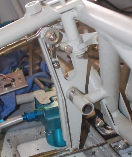

Brief Description:  Autopilot Pitch Control Arm
There have been reports that the TruTrak pitch serve bellcrank attach point was to close to the center of rotation. Accordingly, I moved the attach point up to where the cable turnbuckle ties in to the bellcrank. In addition, I used 3M weatherstrip adhesive to apply a small pad of neoprene where the bottom bellcrank runs into the tubing.
Pitch servo attachment moved.
